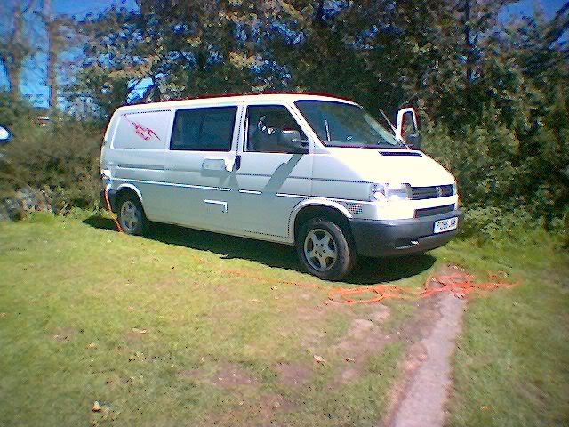

OK Heres the van as I bought it. Bog standard 1996 VW T4 2.5 Diesel.
Used as a home maintenance vehicle by painters since new.
And I have to say...anyone can do this, no special tools were used, though you have to pay attention to the electrics, but having wired up 4 of my houses and several motorcaravans it isnt difficult.
First job was stripping out, someone had dropped a tin of glue and it had seeped through the wood flooring as had some cement.
That done, time for some side windows and new indicators, Note the only rust around the bottom of the door/ diesel filler but it was only minor surface rust.
Time to fit out. There are two Ikea wall units there, one double and one single. The upright with the 240V Sockets and zig unit was some spare Ikea units which were in the skip at the back of the Ikea store. Ive been told there are always these around the back/car parking areas of Ikea. I bet any enterprising person could fit out a van from that throw away stuff. Wall panel carpetting was standard stuff from Rainbow Conversions.
Shows the 240V Circuit breaker box which is connected directly to the outside 240 Camping Hook-up plug. Also can be seen Ive changed the front passenger bench seat for a single one.
And heres the 99% finished version. Just some trimming to do and a few odds and sods but useable
This one showing the water container, now moved to the rear of the van, I dont like fitted water tanks
And as she is now, camping on one of the rare sunny days this year
The missus loading it up
Camera Pic sorry !!
